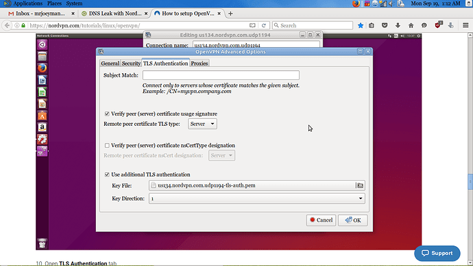

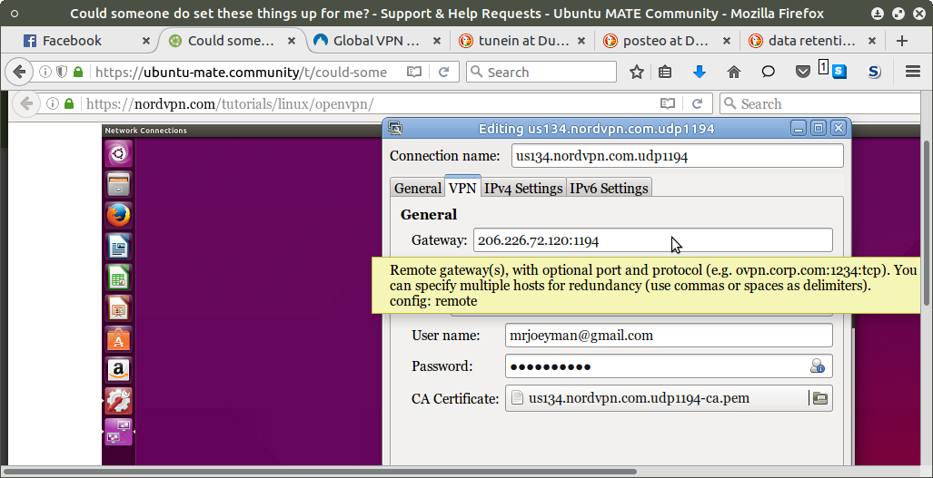

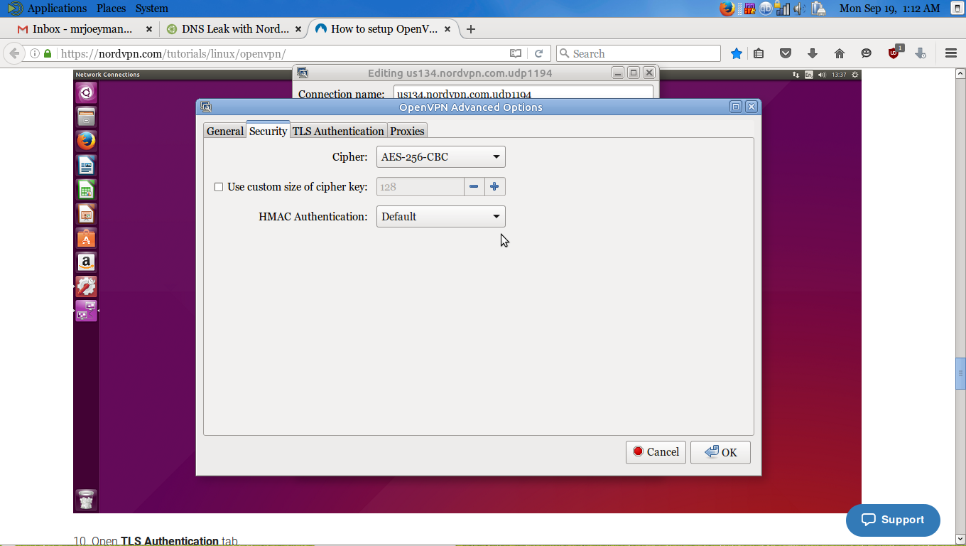

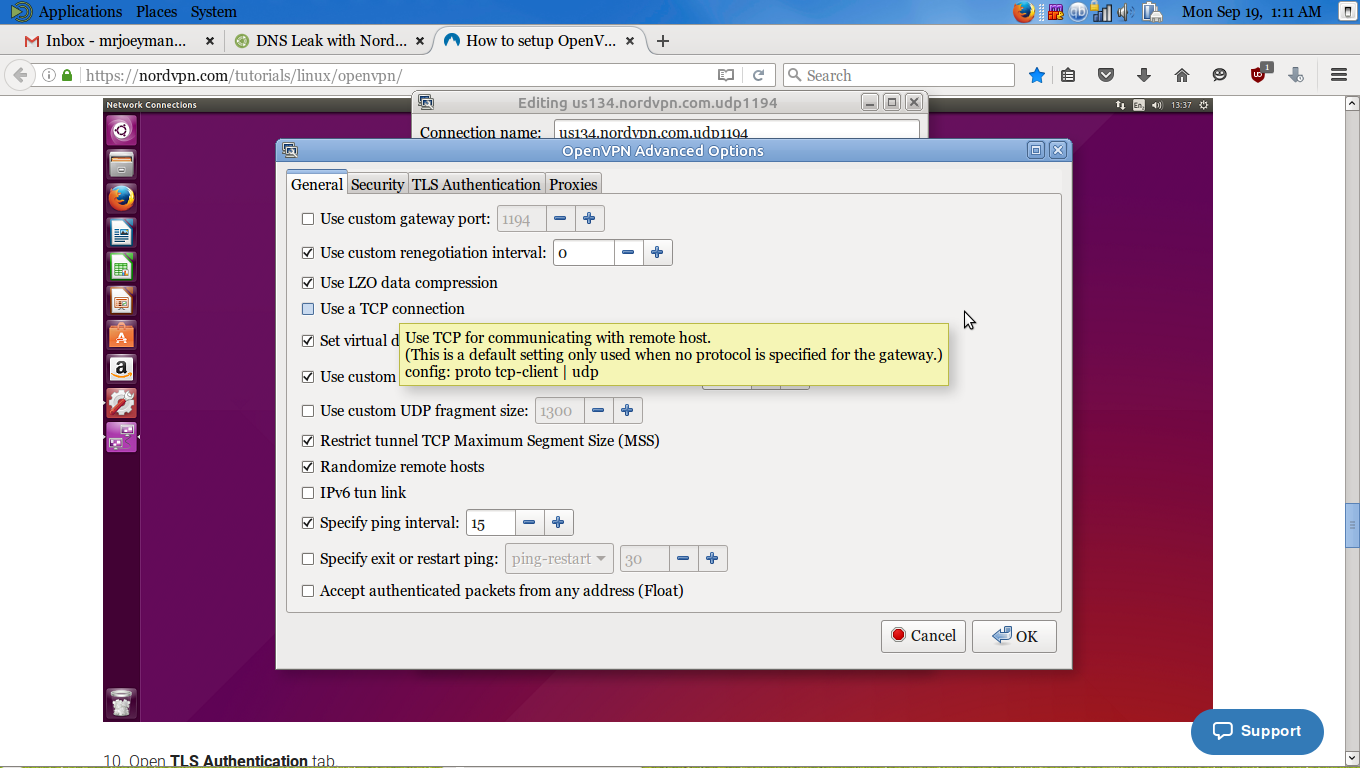

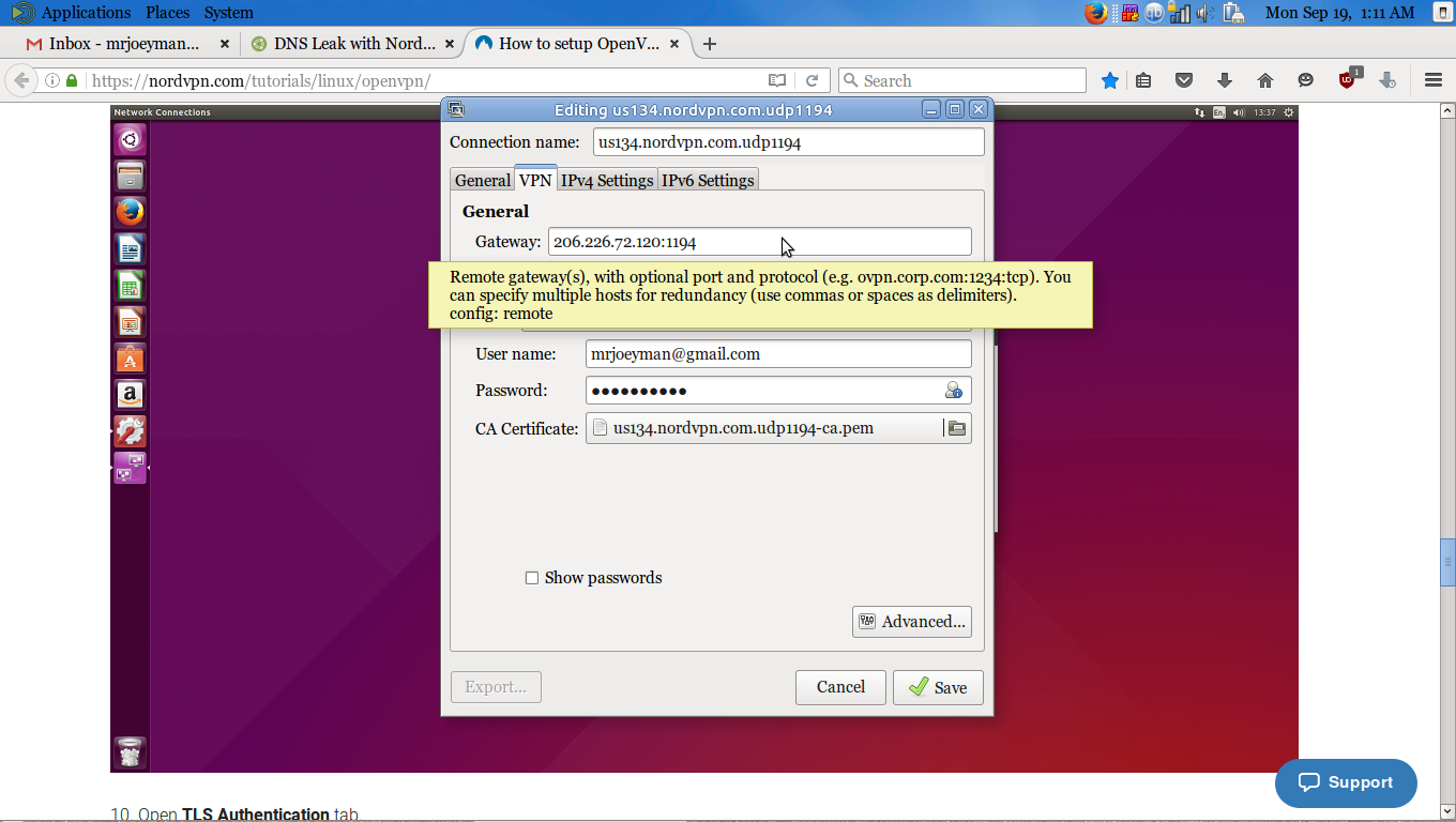

In that post I supplied you the link for you can see that I successfully made a link to connect to one of the Nord VPN servers. If you followed the previous instructions 1-6 you can look at the following screenshots to see if you can duplicate what I did. Click on your network icon at the top of your screen (or wherever you have it, mine is on the top right) and then click on "edit connections" then "add" then "create". I will pick it up with step 7:
Now click "Advanced" and.........

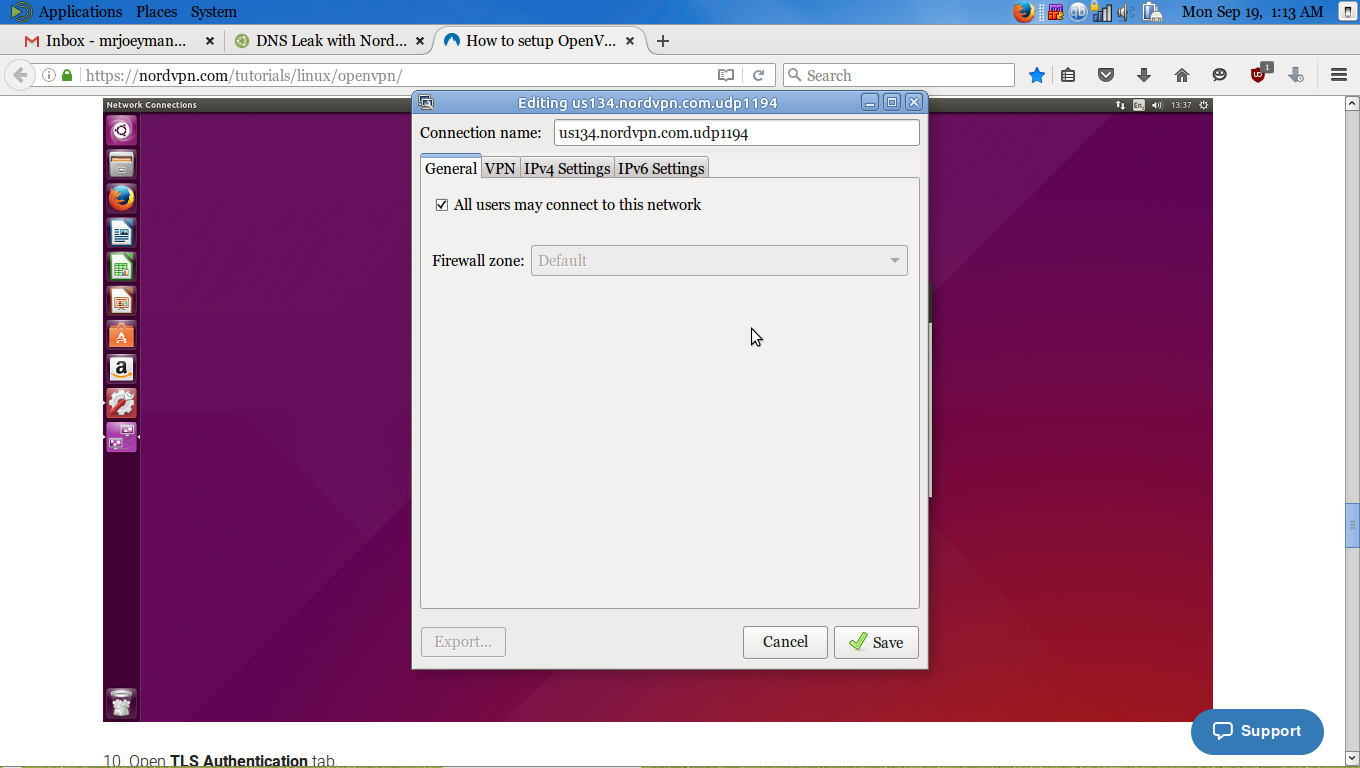

Now "Save", "OK" or whatever and you should have your auto connect.

I get stuck on screenshot # 2 ; i do use TCP443 instead of UDP1194,either dont know what to type in Gateway or where to get CA Certificate ... and the ''save'' option dont give me the option to click ... i guess will give that option until all the whole process is done ???

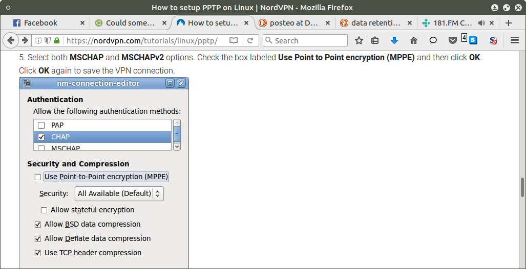

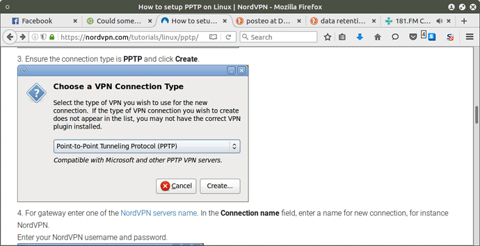

In the Nord VPN how to create connections via network manager they suggest to select PPTP but you did not ?
And MSCHAP /MSCHAPv2 options and MPPE
Or i dont need them or apply just for Windows OS ???

Oh hey i figured it out! To make the VPN connect automatically just go in the connection you use to get internet (for example your wired connection), go in the General tab, tick “Automatically connect to VPN when using this connection” and select your VPN you just setup previously. Hope it works for you too :slight_smile:
