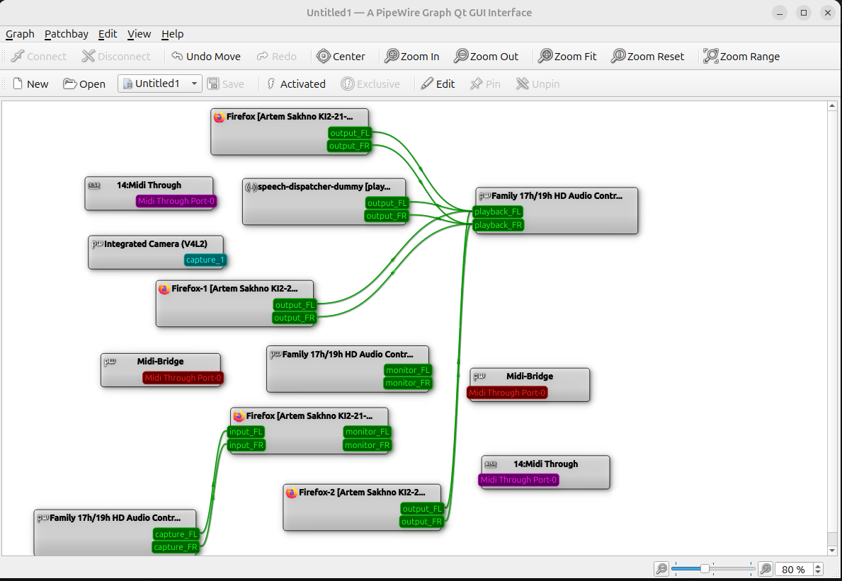

In my Settings → Sound, my “Output Device” is Speakers - Family 17h/19h HD Audio Controller and it works fine, but in “Input Device” where I have Internal Microphone - Family 17h/19h HD Audio Controller it has echo when I speak. In Google Meet I have also option to use microphone “Monitor of Family 17h/19h HD Audio Controller Analog Stereo” but my voice cannot be heard there at all

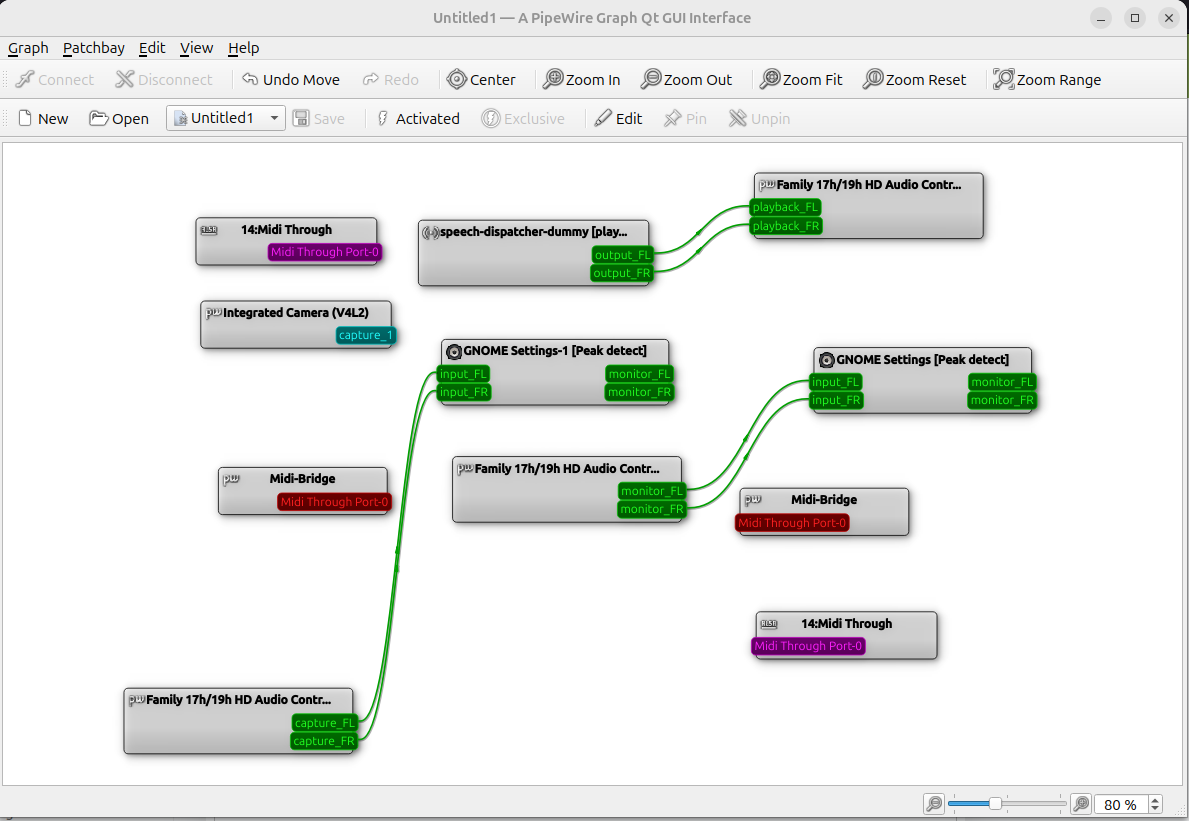

This screen shows the connections when I closed the settings
Screen above shows the connections when I open the settings
Does seem strange to me that there's a path from your speaker (monitor) to the peak-detect (in GNOME settings) as well as a path from the microphone (capture) to peak detect.
Also strange that there's no path to your speaker (playback) - did you hear any sound at all while the graph was in this state?

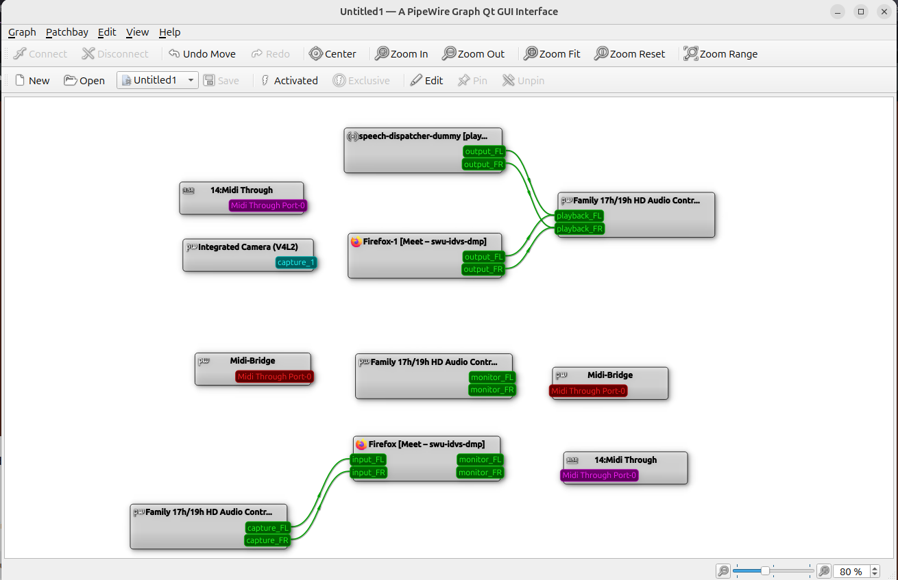

What happens when you open other applications where you use the microphone?
Here what I have in Zoom:
Same in Google Meet.
Both have an echo when I speak, but at the same time I can hear clearly what is being said to me. Also I can watch videos and I can clearly hear without echo.

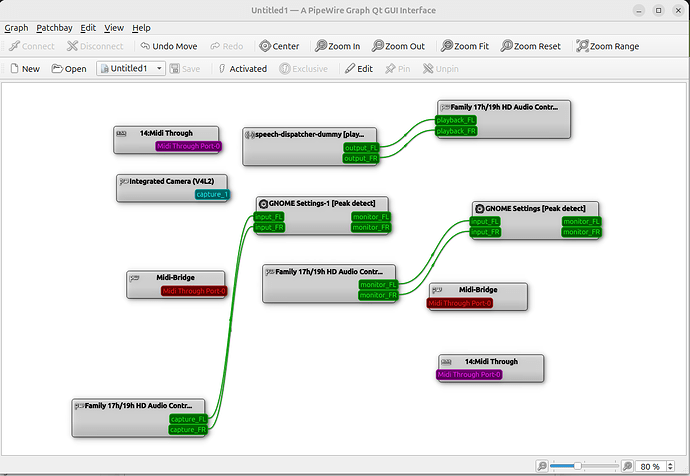

Here what I have in my Settings → Sound:

Otherwise, it looks like there are three tabs playing audio in Firefox. Perhaps one of them is playing back your microphone sound?

Here what I have in Google Meet:
A little bit different from Zoom
