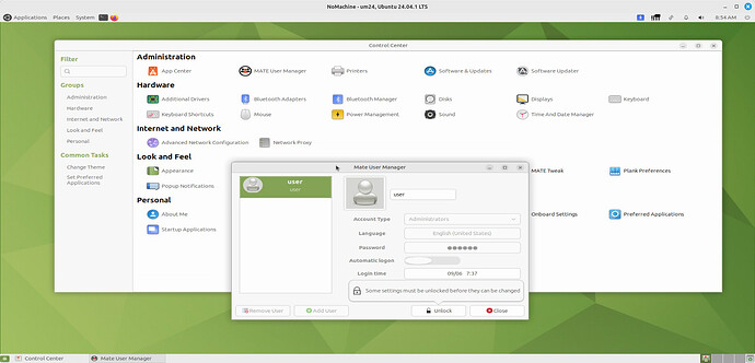

um24 VM, username is user
autologin works, not prompted for pw
user@um24:~$ cat /etc/lightdm/lightdm.conf
[Seat:*]
autologin-guest=false
autologin-user=user
autologin-user-timeout=0
[Seat:seat*]
greeter-setup-script=xhost +LOCAL:
#greeter-session=lightdm-gtk-greeter
not on mine, so what is the issue?
In Control Panel > MATE User Manager, I don't have the automatic logon enabled, see screenshot.
I edited my first post because root cause found.
