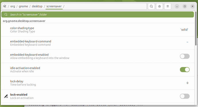

install dconf-editor (sudo apt install dconf-editor)
start dconf-editor, navigate to org.gnome.desktop.screensaver
uncheck lock-enabled
try your sequence again ... suspend, resume, unlock
