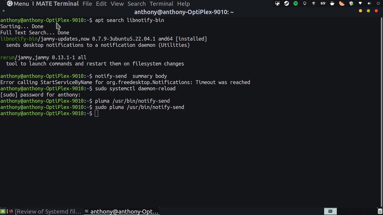

I didn't think it should be empty. The libnotify-bin search returned the text you see, but I reinstalled it anyway. While on a search to get notifications working, I installed the package ayatana-indicator-notifications and then in Ayatana Settings, Notifications was a selectable category. I ran daemon-reload and restarted. I'm under the impression that notifications could be created by either notify-send or ayatana-notifications for the weather program, meteo-qt, that I have.

Would you be so kind to post text output as text instead of a screenshot ?
Otherwise you rob me of the possibility to copy/paste parts of your output into my wiki's and I have to copytype everything by hand. In this case:
Error calling StartServiceByName for org.freedesktop.Notifications: Timeout was reached
and by typing this instead of being able to copy paste from your output, a typo is easily made.
So, please please please, don't post text as pictures !
It is extremely easy (and faster and less kB) to copy paste from terminal into a message on this board.
Anyway, it seems that your notification daemon is not running.

[Unit]
Description=Ayatana Indicator Notifications
PartOf=graphical-session.target
PartOf=ayatana-indicators.target
[Service]
ExecStart=/usr/libexec/ayatana-indicator-notifications/ayatana-indicator-notifications-service
Restart=on-failure
[Install]
WantedBy=ayatana-indicators.target
