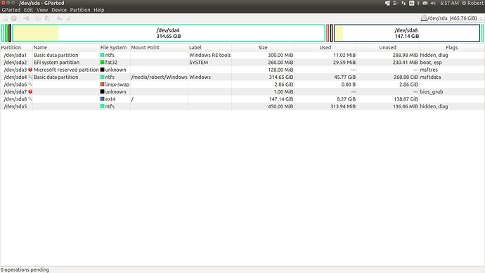

Do you mean straight Ubuntu with no MATE? … I didn’t see multiple linux installs on your gparted screen.
No I have another system also a dual boot Windows 10 and Ubuntu 16.04 also

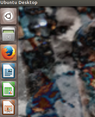

So I assume that you have a "dock" on the left side of the screen and close to the bottom there are mounted drives.
If that's similar to your desktop you should be able to "right click" on any icon an choose undock.
The opposite is also true ... ie if you launch Thunderbird and want it to always be docked simply right click the icon and choose "Lock to Launcher"
here's my upper left screen to compare

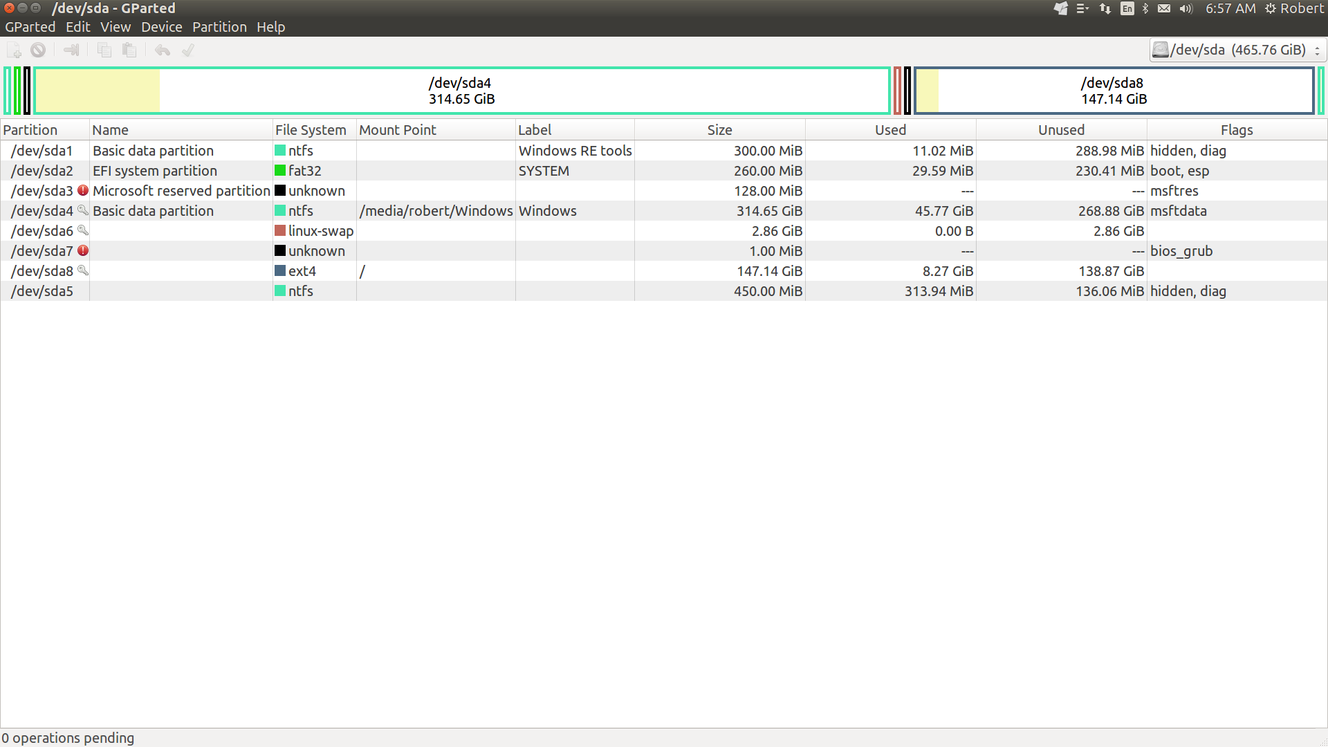

That's not really off topic at all. Again to satisfy yourself refer to the gparted screen shot and notice the different identifiers. Also try that command df -h - it'll display all the places on your drive consuming space.

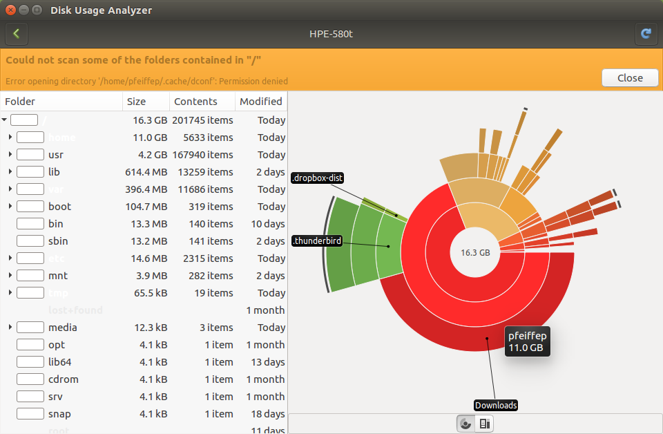

BTW - thanks for pointing out Disk Usage Analyzer. It also displays where the space users are. hover over a space with you mouse and you should see the area with the most space

I used BleachBit ran it and it seemed to clean a lot of unwanted files which is good in my first screen shot you can see my disk space was 147.14 GB and was using 47.95.GB, After everything here's the out come

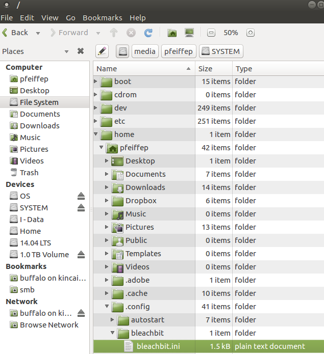

Rename or delete: ~/.config/bleachbit/bleachbit.ini
Then startup Bleachbit fresh again, and it will include your browser.

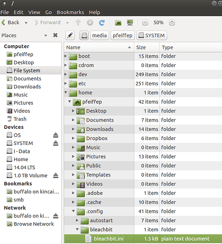

Trying to locate ~/.config/bleachbit/bleachbit.ini
Here's an image of where mine is located ...
This is Mate? I’m not seeing Files System
