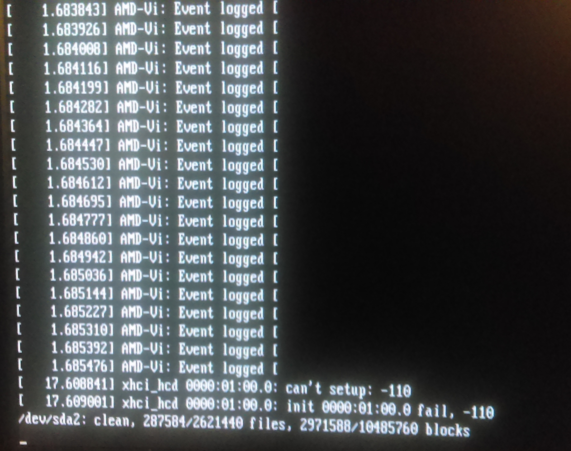

I'm using Mate 17.04. I was doing some research on why I'm getting the following error message at bootup:
What I learned is that the xhci_hcd error message had to do with the USB 3.0 module or drivers. As I understand it, a USB 3.0 drive should recognize a USB 2.0 flash drive, so I plugged one in. Sure enough, it didn't recognize it at all.
This is not causing any problems that I am aware of, other than the error message at startup and that I can't use any of my 3.0 drives. I'm planning on buying a USB 3.0 stick to use for backup, but there's no reason to do that until I get the drive working.
Any thoughts?
Jim
Here's the screenshot form dmesg:
It shows the same error messages, but may give additional information that is helpful.

It’s not physically seeing the USB3.x ports at all. It would be interesting to know if this is a self-built machine or off the shelf.
My final suggestion would be to try a kernel upgrade, and also check to see if your front panel USB3 ports (assuming they’re a presentation plate or built into the case) are wired to the correct pins on the motherboard. The older I’ve got the harder I’ve found it to see the ridiculously small jumper lead IDs :slight_smile:
Unfortunately I don’t have any experience with iommu settings. Hopefully there should be other users with further experience to assist. Good luck and thanks for your time!
I added “iommu=soft” to ‘GRUB_CMDLINE_LINUX=’, ran sudo update-grub, rebooted and disabled iommu in bios. Here are the new results of sudo dmesg | grep -i usb:

I think everything’s working now and it is a self-built machine.
Thanks,
Jim
Good to hear you’ve got it working! Definitely one for the tips and tricks section for others who might have a similar issue! Great work!
