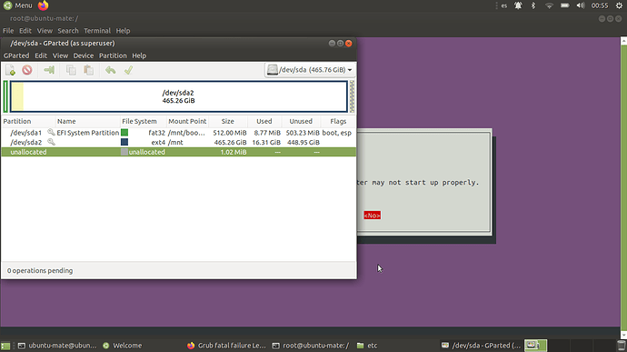

The ubuntu live usb stick has both options to do an efi or non-efi install. Since the laptop boots in efi mode, it will choose the first. LUX, I assume if you look at gparted, your disk sda shows sda1 /boot/efi and sda2 / Still, within the chroot env

Pavlos, I cannot give instructions, system is still in a loop, looks like I have to answer yes to terminate it. I will run gparted from menu and see
GPARTED from menu has not changed, same data
ok, say yes to that screen, it should be back to the # prompt.
Run gparted and see that we have our 2 partitions. Try
grub-install --target=x86_64-efi /dev/sda
grub-install --recheck /dev/sda
It should say, Installation finished, no errors.

GPARTED running form menu has not changed at all.
