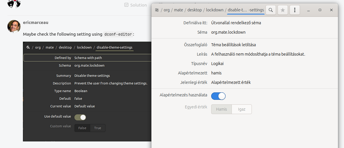

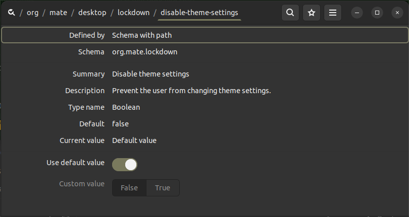

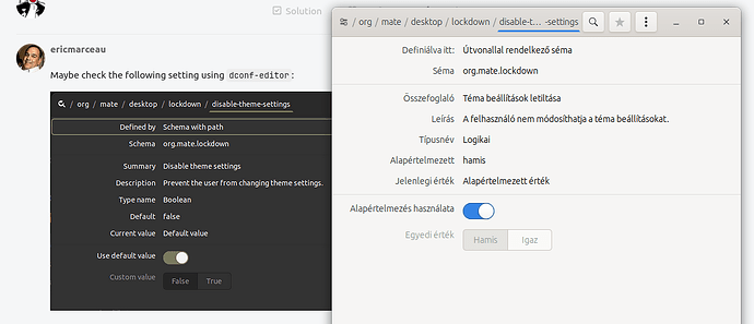

Maybe check the following setting using dconf-editor:
What exactly should I look for in dconf-editor?
You need to make sure that the setting I showed (follow the path in the snapshot) should be set as displayed, to ensure UM does not ignore the theme settings you give to it.
Here is my setup, I see it is the same as yours.

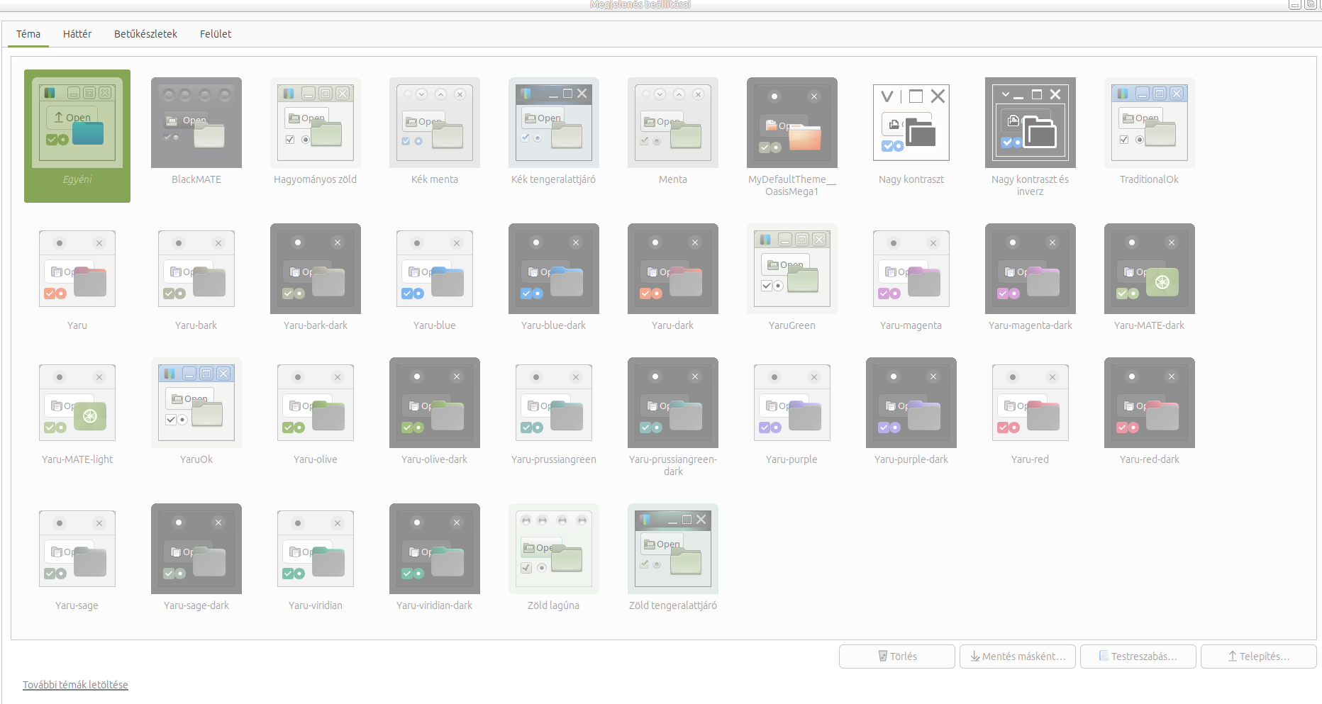

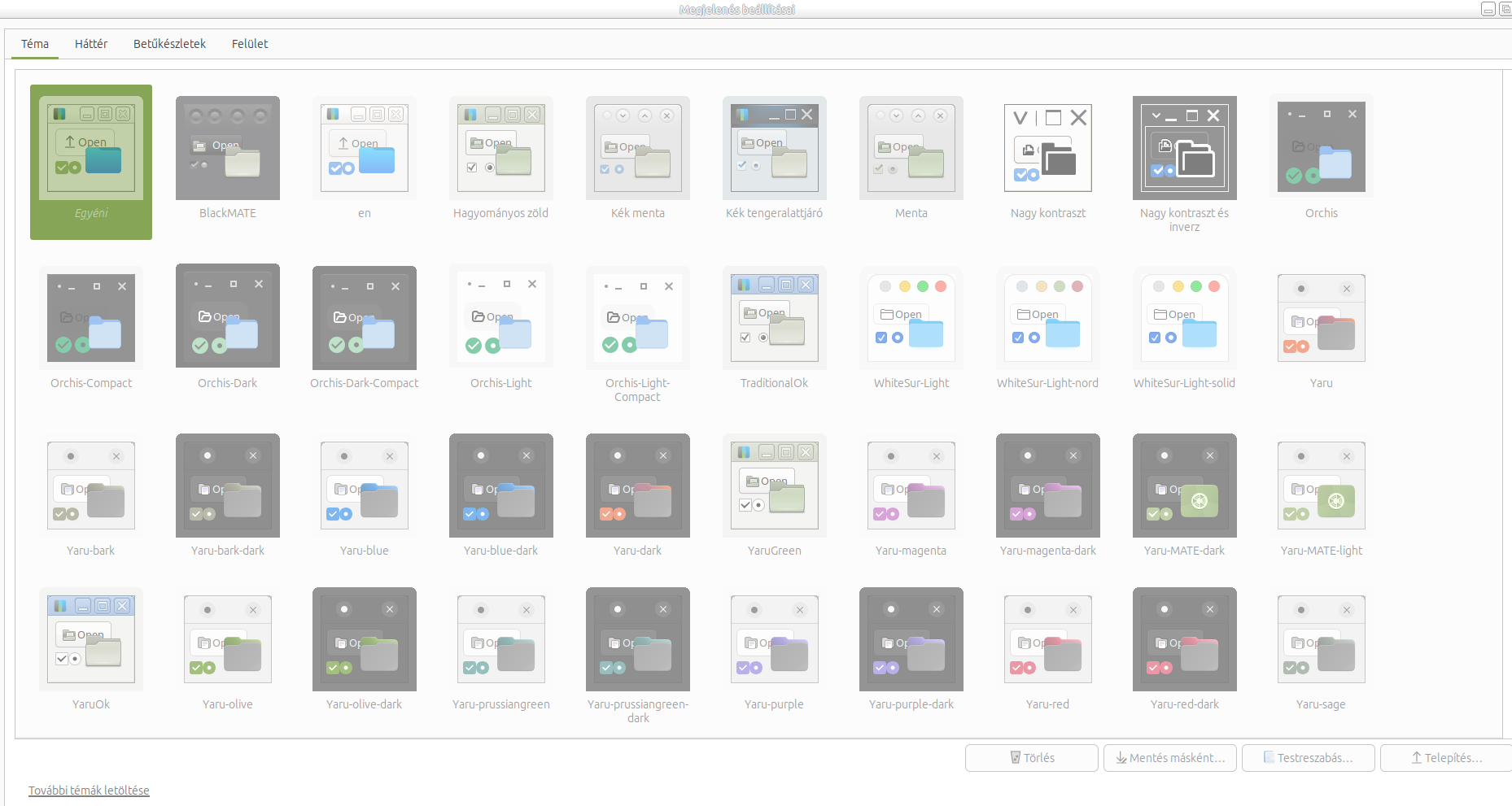

Now the following has happened: when displaying the window called Appearance Settings, selecting the Theme tab, no theme can be selected. All themes are dimmed.
No theme can be selected.
Try selecting a UM default theme, like Yaru-MATE-light (or Yaru-MATE-dark), to see what happens.
I can't choose anything! None of the themes are active for selection, not even the default one. And neither the update nor the reboot helped. The theme marked in green is in use, but cannot be changed.

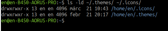

Can you share the results of the following command:
ls -ld ~/.themes/ ~/.icons/
ls -lR ~/.themes/ ~/.icons/

Okay, yeah that list of errors should not block, but it can definitely slow down the rendering (maybe to the point that it feels blocked?).
Several suggestions here:
  1. Just wait. Open the appearance screen and let it load for 5,10,30 minutes and see if it eventually loads.
  2. Your ~/.themes folder might have an issue. I would just rename it to ~/.themes.backup temporarily and see if the application loads. If it does, then create a new empty ~/.themes folder and move the themes one by one into it, loading the application on each one, to see if there's a specific theme that breaks.
  3. Finally, the suggestion from @ericmarceau is good: toggle/reset the gsettings configuration to make sure there's no old stale value locking things up.
  1. I waited for over an hour, it didn't load.
  2. I deleted the .themes folder and created a new one. I rebooted the computer and there was no change. The folder is empty but the same themes are visible as before. Here is the picture. No change. Just a note, the link to download additional themes ( Themes | MATE ) in the display settings window does not work either. Could it be that he’s getting his ideas from somewhere else?
That's all I managed to do so far, the rest later.
Well, Heny, if you are willing, I would ask you to rename
mv ~/.themes ~/.themes.HOLD
mkdir ~/.themes
mkdir ~/.themes/Heny_Test
cat >~/.themes/Heny_Test/index.theme <<EnDoFfIlE
[Desktop Entry]
Name=MyDefaultTheme__OasisMega1
Type=X-GNOME-Metatheme
Comment=
[X-GNOME-Metatheme]
GtkTheme=Yaru-bark-dark
MetacityTheme=Yaru-dark
IconTheme=ubuntu-mono-dark
GtkColorScheme=tooltip_fg_color:#f7f7f7,tooltip_bg_color:#353535
CursorTheme=Yaru
CursorSize=24
NotificationTheme=slider
BackgroundImage=/Local/Untitled_MoonOverDune_green__1440x900.png
EnDoFfIlE
chmod 775 ~/.themes/ ~/.themes/Heny_Test/
chmod 664  ~/.themes/Heny_Test/index.theme
sync ; sync
then, NO REBOOT!
Log out, then log back in. What state is your environment in?
If you go to the Appearance Preferences, can you click on "Heny_Test" as a choice for Theme? If so, does the Appearance visibly change from what you had?
After running the command lines you sent, I logged out and entered the display page. I attached the picture. No change.
There is only one Heny_Test folder in the .thenes folder and an index.themes file in it. Contents: [Desktop Entry]

Sorry! I've exhausted my knowledge of Theme handling.
The issue must be centered other than in User configuration. It must be another subsystem, but I have not clue.
:frowning:
Maybe try on the main Discourse site for Ubuntu. I don't think the breakdown is anything specific to MATE or UbuntuMATE. I am starting to think it is part of the underlying Ubuntu.
No problem, :slight_smile: thanks for the help so far.
