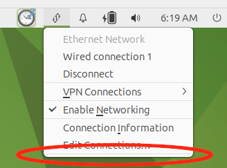

If the buggy behavior I've reported in the past with the icons, boundary lines, and inexplicable brightening up (and advocated for to be fixed) is still present in Ubuntu MATE 25.04, then that's gonna amount to a huge "screw you" to us from the developers. Yes, you read that right. Why no communication? Why no action? The bugs are there; why not fix them (especially since they're so "in-your-face")? Wimpy never responded to me or to anyone on this board (despite financial support from some folks). Nothing. Very disheartening to hear that MATE is still on 1.26. But there's a minor point change of .1 to .2 at the end, so who knows if the bug is fixed?
Update:
So I downloaded and installed the Ubuntu MATE 25.04 LTS beta in VirtualBox. The exact same behavior I reported a long time ago is still present. I am disappointed. The border lines still show up when I'm clicking on another applet, and the program icons near the main menu still brighten up inexplicably when I click on an applet in the left upper corner. See picture below. Yup. A "screw you" to us from the developers. They didn't fix this; not even for a LTS release.
A LTS release. Come on. I don't get why the community isn't saying something about it. I don't get how many can't see the significance of this. It's such an "in-your-face" bug that it interferes with the UX. Would you still shop at a store where the salespeople or whatever walk away after you holler at them to help or something? "Hey, can you help me?" (Salesperson walks away.) "Oh, I guess I'll shop here anyway and support their poor customer service!" Do you see how ridiculous that is? Anyway, I am done. Wow. Good luck to those who keep using MATE.

By the way, there is a redundant separator line in the network manager applet. Have you seen it before? It deserves your close attention too.
Things I noticed were different out of the box:
apt show doesn't text wrap any more.As @omnimaxus mentioned, there are glitches on the panel related to interacting (left-click) with the indicator-applet. Interacting with indicator-applet can "highlight" other panel members depending on a previous interaction with the panel.
If you remove all the other members except for the menu ... then this can also get highlighted.
The result will depend on 'theme':
I don't know how this would be implemented under the hood, but it sure seems like a bug with the panel.
Another thing: if you have the 'hide buttons' (with arrows) on the panel; these can be targets of the 'highlight' too.
